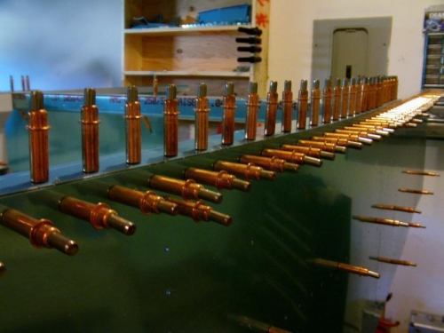

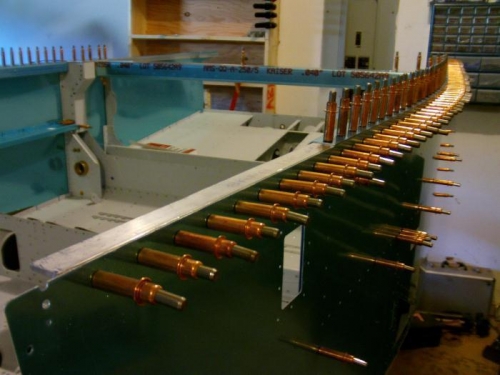

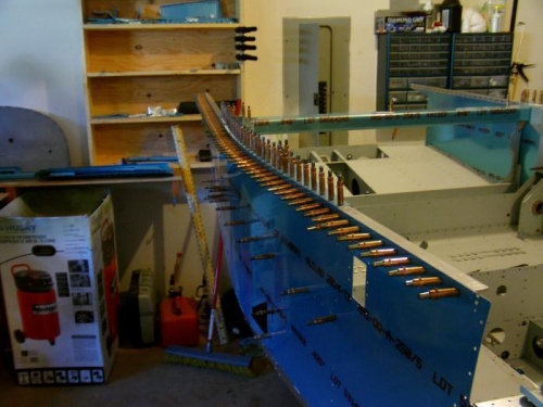

Clecoed fuselage side skins in place. Match drilled all holes common between longerons and side skin, and between longeron and roll bar attach plates (page 23-06, steps 2 and 3).
Longeron Drilled - LH Side
Longeron Drilled - RH Side
Longeron/Skin LH Side
