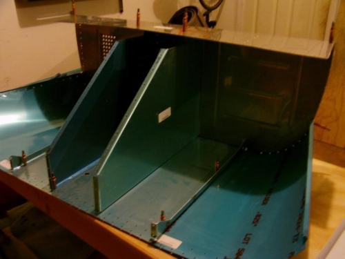

After many reviews of the lower forward fuselage assembly in Section 22, still have alot of questions so decided to cleco the major components together and then re-reviewed the instructions. Most questions answered and made much more sense. This section should be more straightforward than before trial assembly.

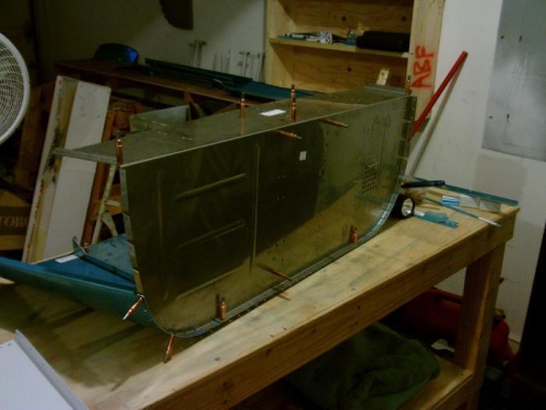

Trial Assembly - Looking Fwd
Trial Assembly - Looking Aft
