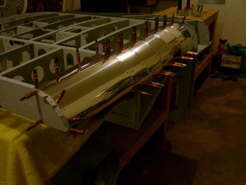

Dimpled fuselage skin nutplate attach holes around each access hole. Also, drilled holes for nutplates for the comm antenna (called out as optional on page 21-16). Broke edges on outer edges of fuselage skin (page 21-15, step 3). Lightly scuffed bottom skin, corner skins, bottom stiffeners, and doublers, cleaned with Acetone, and primed.
Installed fuselage corner skins (page 21-15, steps 2 through 7).
Page 21-15 is complete.

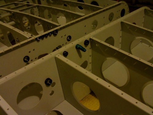

Taking the advice of other builders, installed the bulkhead fuel fitting (page 28-06, step 1).
Primed Bottom Fuselage Skin
Corner Skins Installed
Bulkhead Fuel Fitting
