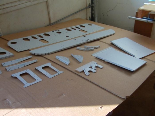

Dimpled holes in step ribs and nutplate attached holes in upper flange of the F-1202F bulkhead (page 21-xx, steps 2, 3 and 5).
Lightly scuffed all prepared parts with Scotch Brite pad, cleaned with Acetone, and primed.
Primed Parts
Primed Parts

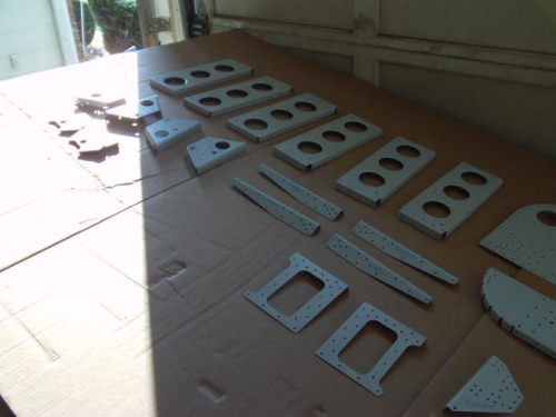

More Primed Parts
More Primed Parts
