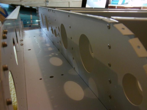

Riveted baggage ribs to aft center section bulkhead with manufactured head of rivets on forward side of bulkhead. Was able to swivel head 90 degrees on the pop rivet hand squeezer and et to all of the rivets. Very tight but doable. Riveted baggage floor to ribs (page 21-02, step 4).

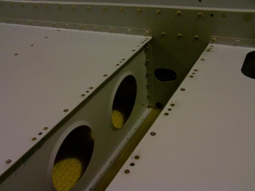

Riveted nutplates along inner edge of each baggage floor (page 21-02, step 5)

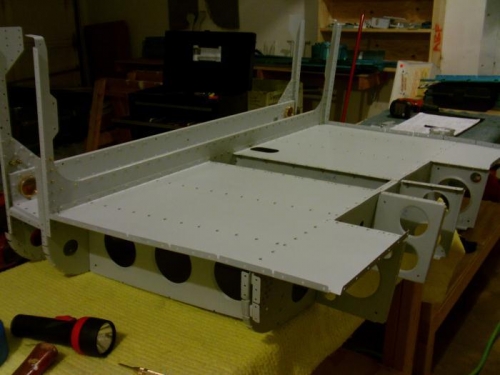

Riveted the F-1206A bulkhead and F-1206G and H baggage ribs to the baggage floor assembly. (page 21-03, steps 1 and 2).
Baggage Rib Rivets
Baggage Rib Rivets
Nutplates in Baggage Floor
Baggage Floors and Ribs
