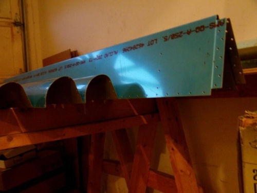

Prepped RH Flaperon Skins
Deburred skins and brackets, lightly scuffed with Scotch Brite pad, cleaned with Acetone, and primed. (page 18-04, step 8).
Page 18-04 is complete for left and right flaperon.
RH Flaperon Skins Primed
