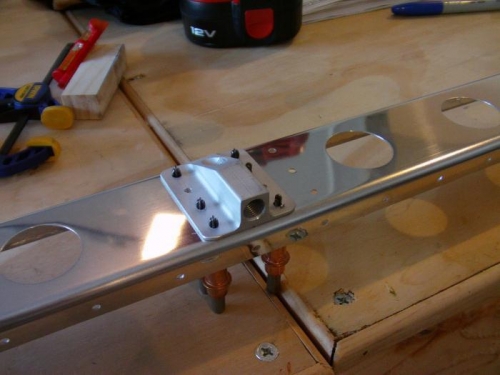

Got the pivot brackets remade and verified that the dimensions are correct. Also, deburred and fluted parts that were lost (A-1204-L & -R outboard nose ribs) (page 18-02, steps 2 and 3).
Page 18-02 is complete.
Riveted A-1208 bracket to A-1210-L inboard nose rib for left flaperon. Clecoed and matched drilled A-1206 pivot brackets and A-1207-L actuation bracket. Deburred parts. Deburred skins and brackets, lightly scuffed with Scotch Brite pad, cleaned with Acetone, and primed. (page 18-04, steps 3 through 8).

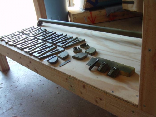

Pivot Bracket Match Drilled

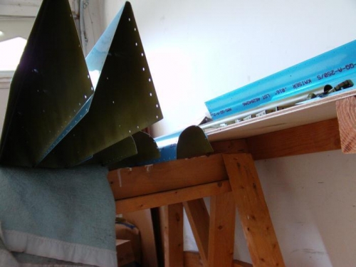

Skins Primed
Skins Primed
Flaperon Parts Primed
