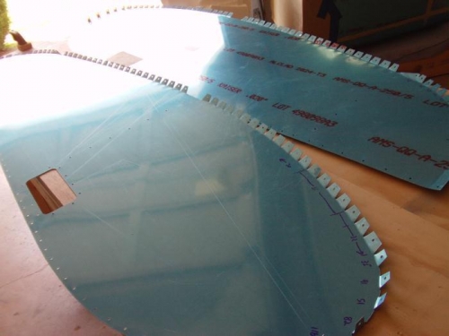

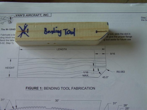

Built bending tool and bent tabs on both W-1204D-L & -R wing tip close out skins. Used an adjustable protractor to check angles. (page 17-06, step 1).

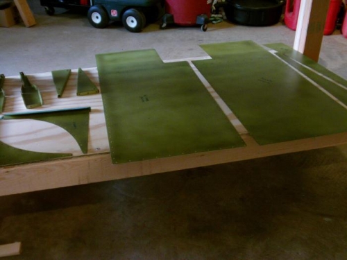

Lightly scuffed wing tip skins (W-1204G-L & -R hand holds, W-1213-L & -R tip ribs, W-1204C-L & -R bottom skins, W-1204B-L & -R aft skins, W-1204A-L & -R forward skins, and W-1204D-L & -R close outs) with Scotch Brite pad, cleaned with Acetone, and primed.
Bending Tool

Skins Primed
