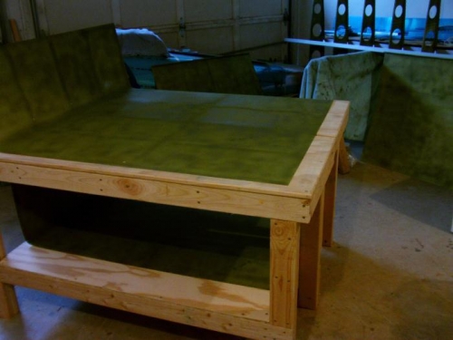

Primed Right Wing Skins
Lightly scuffed all three right lower wing skins and all three upper wing skins with Scotch Brite pad, cleaned with Acetone, and primed.
