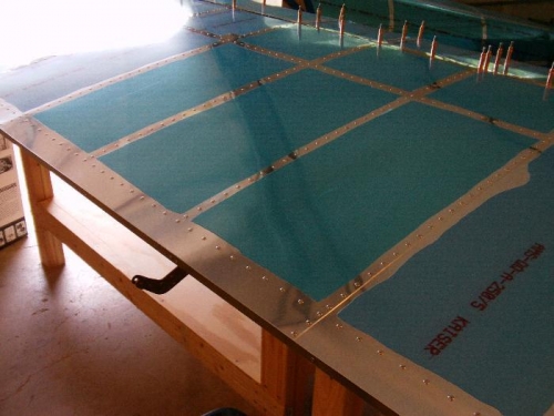

Riveted left mid upper wing skin W-1202B (page 17-04, step 1).

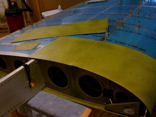

Dimpled holes in left and right wing walk doublers W-1201C-L & -R (page 17-04, step 2).
Deburred and trial fit left wing walk doubler. Had to roll the lower edges of doubler, especially on the inboard side. Masked wing in doubler area and prepped by lightly scuffing with Scotch Brite pad, cleaned with Acetone, and primed. Also prepped inner surface of doubler.
Dimpled VA-195H access hatch and prepped by lightly scuffing with Scotch Brite pad, cleaned with Acetone, and primed (page 17-04, step 5; dimpling only).
Mid WIng Skin Riveted
Wing Walk, Doubler, and Access Hatch Prepped
