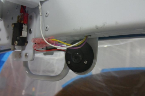

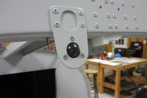

Brief Description:  Finished Eyeball Light Install
The snap bushing in step 2 was previously trimmed when wires were installed.
Spliced cockpit wires to eyeball lights. Verified, via continuity, that cockpit wires are connected as follows:
-Options connector pin 18 is the LIGHT - wire and connected to eyeball light black wire.
-Options connector pin 32 is the LIGHT + wire and connected to eyeball light red wire.
Riveted eyeball light to light bracket. Attached splices to rollbar with red RTV (tape holding in place until cured). (steps 10 through 12)
Step 13 and 20 are NA (remove install upper forward fuselage skin).
Steps 14 through 17 previously done during wiring installation.
Not sure what steps 18 and 19 are suppose to accomplish but do not appear to be applicable.
PAGE 40-11 IS COMPLETE
