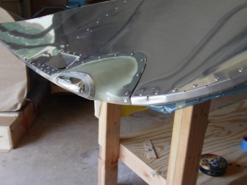

Brief Description:  Finished Nav/Strobe Lights
Finished LH and RH light extensions by applying fuel sealant to lower flange and riveting extensions to wing. Connected Molex connectors, installed nav/strobe lights, and secured with set screw (page 40-09, steps 1 through 7 and 14).
Page 40-09 is complete
Although not part of the plans, secured Molex connectors together by installing tie wrap prior to pushing connector into wing tip extensions.
Removed blue vinyl from wing skins.
LH Nav/Strobe Light Complete
RH Nav/Strobe Light Complete
