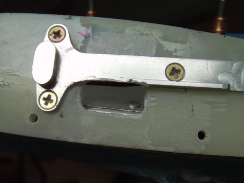

Resolved Oval Cutout Issue - RH Extension

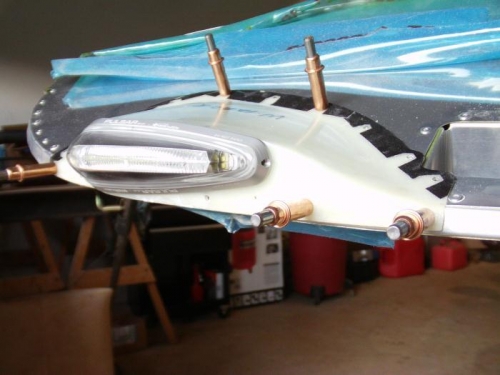

After a number of emails back and forth with Ken at Van's, he suggested nipping into the light bracket enough to provide clearance for the connector. Worked fine.
Bracket Cut for Connector Clearance
Light Trial Fit
