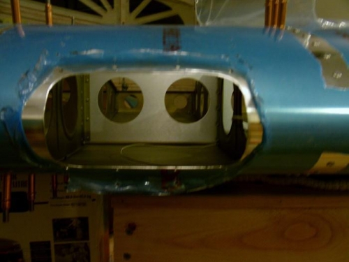

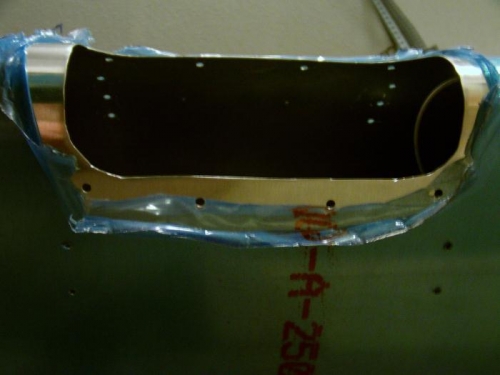

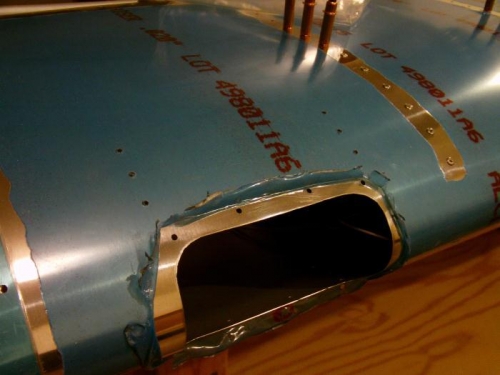

Installed template and marked all hole locations with a punch. Also marked landing light cutout opening. Aligned template for upper half and repositioned for lower half marking (page 40-02, step 1).
Drilled rivet and screw holes marked with a punch with #40 and then final drilled to #30 (page 40-02, step 2).
Using a Dremel tool and abrasive cutting disk, cut landing light opening. Finished filing to final opening size and then polished edges (page 40-02, step 3).
Top Side View
Top Side View
Straight On View

Bottom Side View
Bottom Side View
