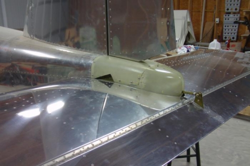

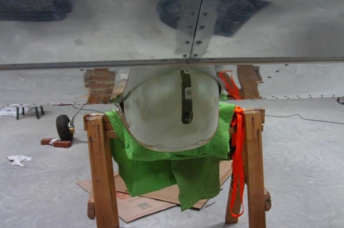

Brief Description:  Complete Tailcone Fairing Install
Page 12-10
Drilled hole in bottom fairing. Installed tailcone and secured with clecoes. Trim servo previously installed. Fully retracted trim servo and moved stabilator full travel. Powered pins 31 and 32 on fuselage harness at AV-50000A control module instead of powering via molex pins at servo. The bottom of the servo arm hit on the forward side of the hole so enlarged hole until it cleared. Fully extended trim servo and moved stabilator full travel. The trim rod hit the bottom aft end of the fairing slot so extended cutout until rod was clear of the slot. (steps 7 through 12)
PAGE 12-10 IS COMPLETE
Page 12-11
Installed tailcone fairing and secured with screws. Re-checked all clearances on stabilator, spar box, rudder, and trim/servo assemblies. All clear. (steps 1 and 2)
PAGE 12-11 IS COMPLETE
SECTION 12 IS COMPLETE
