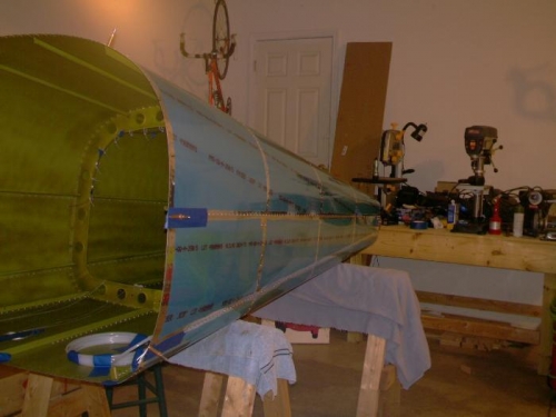

Riveted left and right side skins to fuselage frames (F-1208, F-1209, and F-1210), upper left and right skins, and hinge bracket (page 10-09, step 9).
Page 10-09 is complete
Dimpled forward skin rib and nutplates. Lightly buffed with Scotch-Brite pad, cleaned with Acetone, and primed forward skin rib. Riveted nutplates to forward skin rib. (page 10-10. steps 1 through 5).
Final fit top skin and clecoed into place. Match drilled two outer holes in angle and had to file edges of angle a bit to make sure skin fit correctly. Also slightly increased break angle toward aft end of top skin. (page 10-10, step 6).
Clecoed J-stiffener into place (page 10-10, step 8).
Masked off holes at forward edge (page 10-10, step 9).
Picture shows completed tail cone. Had a problem with the camera and not able to get in-process photos.
