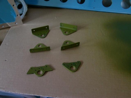

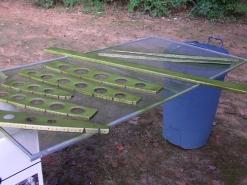

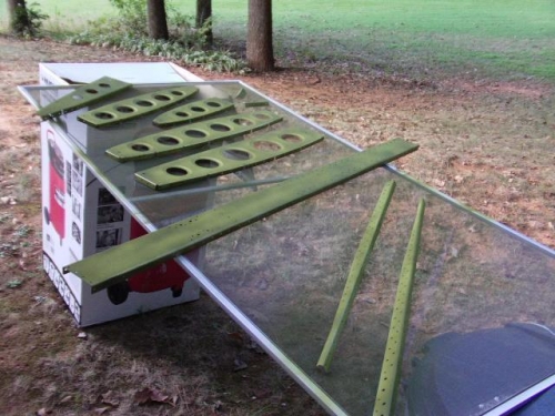

Prepared all V stab components (except skin) including front spar, ribs, rear spar, spar caps, rudder hinges, and rudder spacers. Prep consisted of lightly scuffing with Scotchbrite pad and cleaned with Acetone. Primed with TEMP A-702 self-etching primer.
Rudder Hinges and Spacers
Spars, Caps, and Ribs
