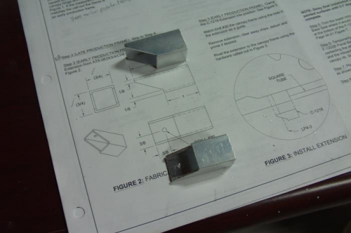

Fabricated LH and RH canopy frame extensions. (step 2)

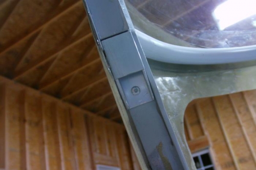

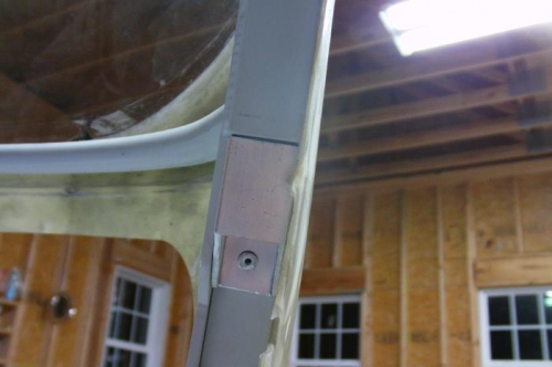

Positioned frame extensions into canopy frame and match drilled. Removed and deburred hole. Reinstalled and secured frame extensions to canopy frame with rivets. (step 3)
