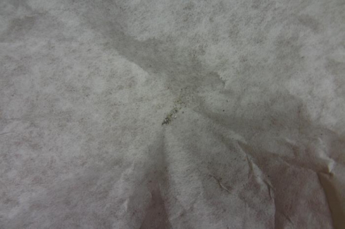

Removed gascolator drain and strained fuel through a coffee filter. Minor swarf was noticed and looked like very fine flakes of aluminum. Probably stuff left in the fuel lines/tank during construction. Very happy with the minimal amount found.

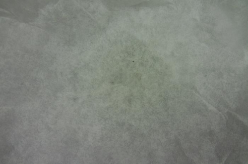

Removed both carb bowls and strained fuel through a coffee filter. Very minor black material caught. Again, probably small pieces of fuel tank sealant.

Minor Swarf From Gascolator
Minimal Debris in Carb Bowls

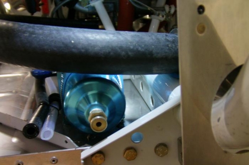

Gascolator Safety Wired
