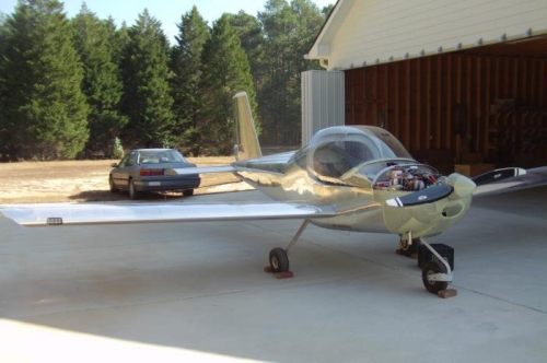

Tied to Car
Tied to Car
Ready to Start
Ready to Start
