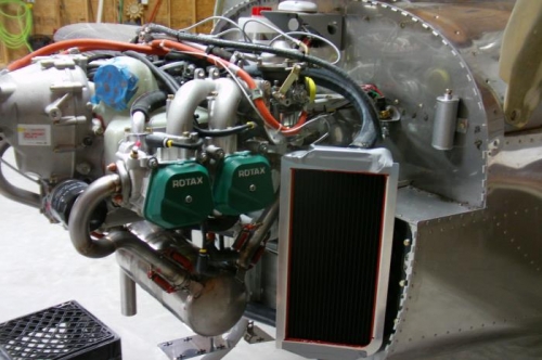

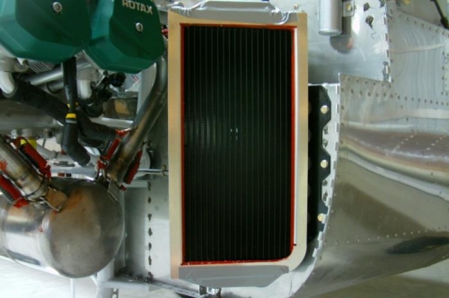

Page 49-05
Bolted heat exchanger to firewall and cooler box face/ribs. Required mount holes to be slotted and three AN960-10L washers at each inboard mount location to get proper gap between heat exchanger and ribs. (steps 1 and 2)
Installed seal face and secured to heat exchanger at the top and bottom with red RTV and duct tape. Masked off heat exchange face and applied fillet seal around perimeter. (step 3)
Installed upper and lower radiator hoses to heat exchanger. Secured lower radiator hose to nose gear leg with cushion clamp. (steps 4 and 5)
PAGE 49-05 IS COMPLETE

Heat Exchanger & Seal Face
Heat Exchanger & Hose Install Complete
