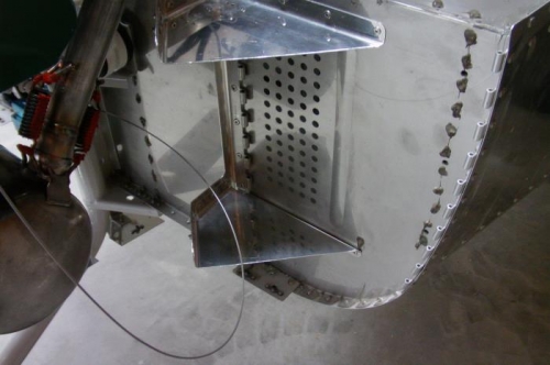

Riveted cooler box face and matching cooler box hinge to firewall. (step 1)
Riveted upper and lower cooler box ribs to firewall and then to cooler box face. (steps 2 and 3)

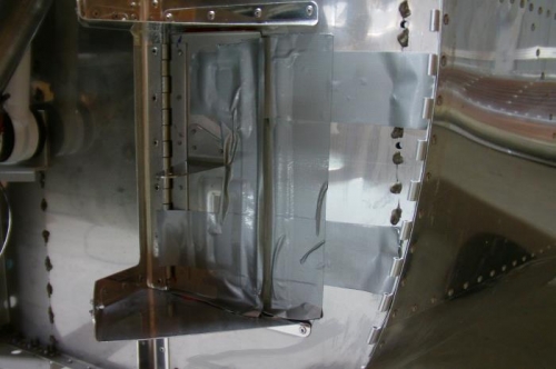

Covered firewall differently than called out in the plans based on lack of success of other builders. Used packaging tape with a thin layer of olive oil (did not have vaseline) as a parting agent. We'll see if that works in a few days. (step 5)
Scoured aft face of cooler box door and cleaned with Acetone. (step 6)
Added bead of red RTV on aft face of cooler box door, then installed door and secured with hinge pin. Used duct tape and secured door in the closed position and will wait a few days for sealant to cure. Safety wired hinge pin to upper cooler box rib. (steps 4 and 7)
Cooler Box Parts Riveted to Firewall
Door Closed and Duct Taped

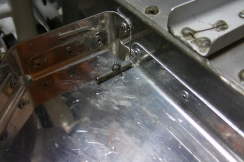

Hinge Pin Safety Wired
