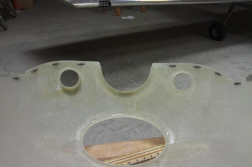

Received additional K1000-08 nutplates so ready to complete this section.
Page 38-07
Match drilled nutplate rivet holes for knuckle and front holes in bottom cowl. Countersunk rivet holes, then riveted nutplates to bottom cowl.
Page 38-07 IS COMPLETE
Page 38-09
Removed cowl close-out, dimpled nutplate rivet holes, and dimpled nutplates. Riveted nutplates to cowl close-out. (step 6)
Installed bottom and top cowl. Fiberglass did not extend beyond the cowl close-out so no snading required. (step 7)
PAGE 38-09 IS COMPLETE
SECTION 38 IS COMPLETE
Bottom Cowl Nutplates
Cowl Close-Out Nutplates
