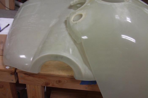

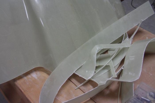

Brief Description:  Start Trimming Cowls
Trimmed edges of top and bottom cowls with a combination of dremel with cutoff wheel and tin snips. Finished to scribe lines with 80 grit sandpaper. Not sure what areas to remove on the large upper opening in the bottom cowl. There were no scribe lines and no dimensions provided on the KAI. Got an email into Van's asking for clarification before trimming. (step 1)
