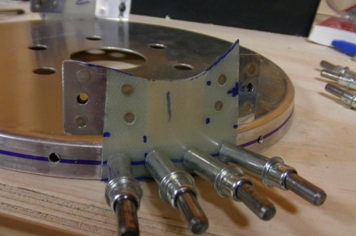

Tapped sacfricial nutplate and used that and a screw to match-drill #40 holes for all nutplate locations. (step 5 - final)
Machine countersunk gap filler holes. Machine countersunk all nutplate rivet holes. Deburred holes and riveted nutplates onto spinner plate, spinner bulkhead, and back plates. (steps 6 and 7)
Riveted back plates to gap fillers, then riveted assembly to spinner plate. (step 8)

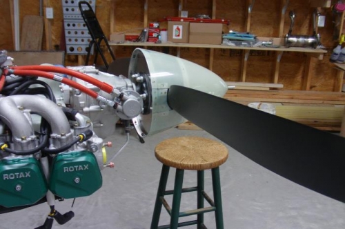

With Denise's help, installed the spinner plate and hub mount half and secured with flange bushings, bolts, Nordlock washers, and nuts. Step torqued bolts in a crisscross pattern to 120-175-235 inch-pounds. Attached propeller blades, hub clamp half, spinner bulkhead, S-1208 spacers, Nordlock washers, and bolts. Prior to tightening, set propeller pitch to #3 on Sensenich pitch tool. Tightened bolts just enough so blades do not move. Final torque will be done after final blade angle adjustment. (step 9)
Nutplates on Spinner Bulkhead
Gap Filler/Back Plates on Spiiner Plate
Ready for Final Blade Angle Adjustment
