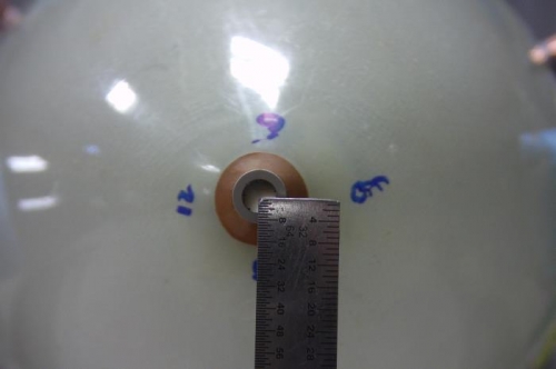

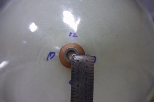

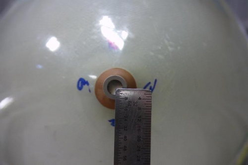

Page 47-04
Set up a convoluted fixture so that camera was positioned to capture close up of pitot tube without moving so a series of photos can be taken and compared to each other. Marked spinner with 3, 6, 9, and 12 o'clock positions for reference. Set up a ruler similar to that specified in the KAI. (step 1)
Removed lower spark plugs. (step 2)
After repeated attempts, got the spinner adjusted to minimize any kind of wobble, then secured with cleco clamps. (step 3)
PAGE 47-04 IS COMPLETE
12 o'clock Position
12 o'clock Position
9 o'clock Position
9 o'clock Position
6 o'clock Position
6 o'clock Position
