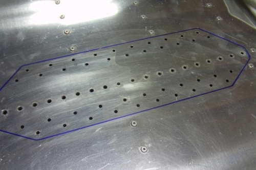

Clecoed doubler to skin, match drilled #30 holes. Cut a piece of old instrument panel skin and used it under wing skin to protect spar cap. There were holes in the metal piece and might have accidentally aligned those holes with matched drilled holes so might have lightly tapped the spar cap a couple of times with the drill bit. Opened eight called out holes to 5/32" (plans called for #22 drill bit. 5/32" was slightly smaller than #22 but worked out fine - BSPQ-5-2 rivets fit fine). Removed clecoes, deburred holes, and chamfered edges of doubler. (steps 6 through 10)

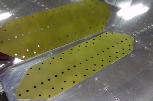

Primed skin and mating side of doubler. Scuffed with Scotch Brite pad, cleaned with Acetone, and primed with Zinc Phosphate primer. (step 11)
Clecoed doubler in place and riveted doubler to skin, spar flange, and main rib. (step 12)

Match Drill Holes
Match Drill Holes
Prime Mating Surfaces
