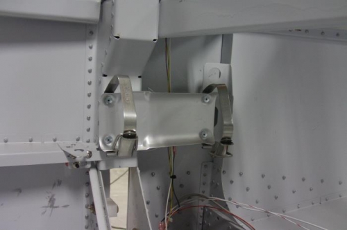

Received SD-42-BSLF rivets from Van's and glad I order extra ones. Trial fit the ELT with the tray mounted in the correct position and was so excited that it fit that I proceeded to rivet the tray in place - without the freakin' straps! Had to drill out rivets again and then installed tray AND straps correctly this time.

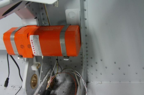

Tried to latch the ELT to the tray but it was very difficult to engage the BATTERY strap. The rivets for the ELT bracket were hitting the aft end of the ELT just enough to keep the ELT from fully seating. Was able to push it back enough to engage the straps but aft end of ELT body is tight against the rivets. Connections made as follows:

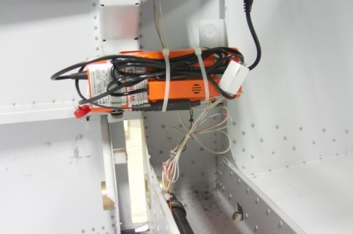

Tie-wrapped the whole mess to the ELT. Not the neatest installation that I have ever seen but is per the plans. (page 42F-04, steps 1 {remaining part} through4).
Tray and Straps
Tray and Straps
Tight Fit at Aft End of ELT
Final Installation
Final Installation
