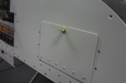

Struggled since day one in trying to get the HW 2600-3W camloc fastener to work. Always seemed too short and would not engage camloc receptacle. Finally bought a HW 2600-6W camloc fastener and finally got it to latch properly. (page 29-06 step 5 redo)

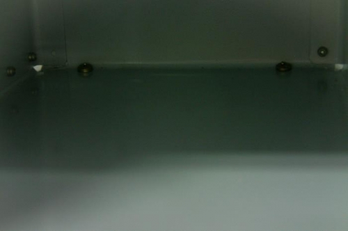

Secured back of map box to panel shelf with called out hardware. Secured right instrument panel with screws. (steps 2 and 3)

Door Latch Camloc
Door Latch Camloc
Map Box Screws
Map Box Screws
