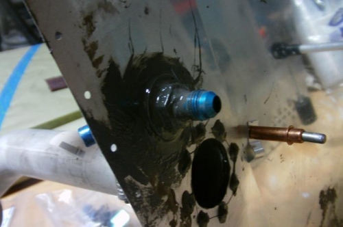

Brief Description: Installed Vent Fluid Fitting & Cap
A batch of CS-3204 Flamemaster B2 sealant was already mixed up for the failed attempt to install the tank doublers for SB 13-12-19 so installed the tank vent bulkhead fitting.
Smothered spacer and flange of bulkhead fitting with sealant, installed into tank top skin, and secured with nut. Liberally applied sealant around the bulkhead fitting and nut inside the tank. (step 3) Step 3 of page 37B-03 references page 37-05, step 5 to install the fitting. The reference is in error and should refer to page 37-06 (not 37-05).
