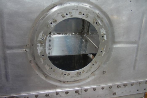

Removed the res sender plate. Removed old sealant with a phenolic scraper and MEK. (step 3)

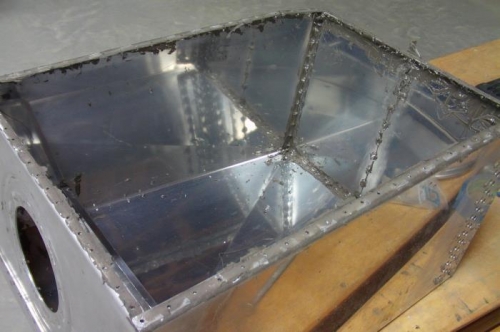

After seeing the access, or lack thereof, to the corners where the doublers will be installed, decided to follow the route of other builders and remove the top tank skin.

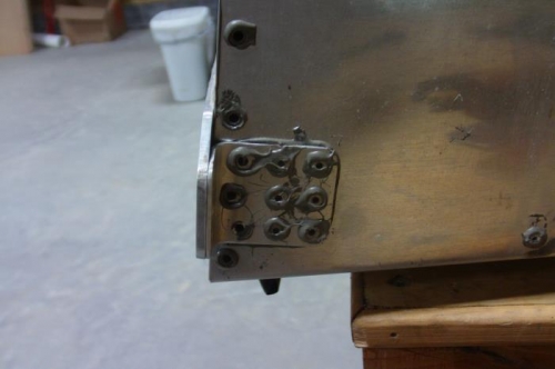

Removed nutplates and rivets specified in figures 2 and 3. (step 5)
Disconnected fuel return line. Actually removed fuel return line as part of removing the fuel tank top cover. (step 6).
Res Sender Plate Removed
Inbd Rivets Removed
Inbd Rivets Removed
Fuel Tank Top Panel Removed
