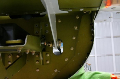

Brief Description:  Connected Stabilator Cables
Connected stabilator cables to stabilator horns. Getting the washers between the clevis and the horns was a bit of a challenge so Denise helped again when more than two hands are required. Added Aeroshell Grease No. 5 to bolt shanks during installation. Tightened castellated nuts finger tight to remove slop and secured with cotter pins. (step 6)
PAGE 32-13 IS COMPLETE
Tightened turnbuckles a bit so they didn't accidently disconnect - they were only engaged a couple of threads during initial install.
Upper Cable
Upper Cable
Lower Cable
