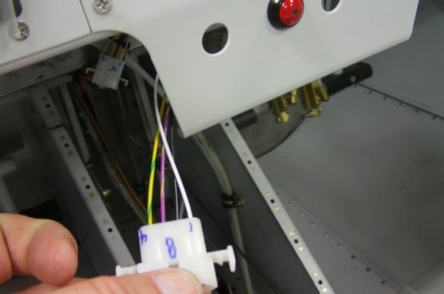

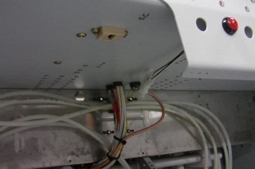

Brief Description:  Install AP Disconnect Button
Previously enlarged hole in center instrument panel to 1/2" while prepping the center panel (see control module entry on 7/4/16). Inserted wires through panel hole and secured disconnect button with star washer and nut. Inserted wires into applicable receptacle pins and connected with mating receptacle (installed on page 58-05).
AP Disc Button Wire Connector
Button Install Complete
