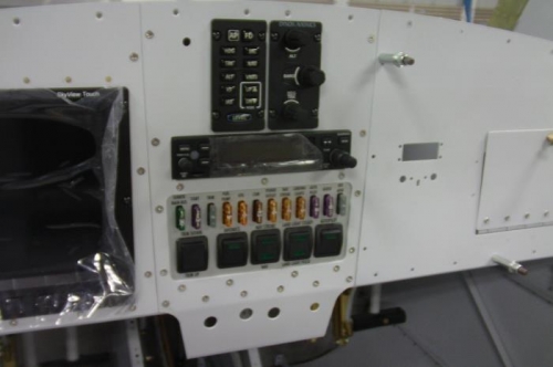

Machine countersunk nutplate rivet holes in center panel. Rivet nutplates to center panel. Actually already accomplished these two steps while prepping the panel in section 42M. Disconnected wires from pins 15, 18, and 19 from connector at the power & switch module, cutoff pins, folded wires back onto harness, added heat shrink, and tie wrapped to the harness. (steps 1 through 4)
PAGE 58-04 IS COMPLETE
Page 58-05
Routed WH-00105 AP-knob harness between center panel and AV-5000A control module. Connected harness to the control module. Inserted three loose wires to pins 15, 18, and 19 of the switch harness. Reassembled the backshell and connected to the power & switch module. (steps 1 through 3)
Page 58-06
Connected wire harnesses to autopilot and knobs panels and secured panels with screws provided with the panels. Never removed skyview display or GTR200 radio as part of this section so step 3 is NA. (steps 1 through 3)
Center Panel Ready
Center Panel Ready
Wire Mod to Switch Harness
Panels Installed
