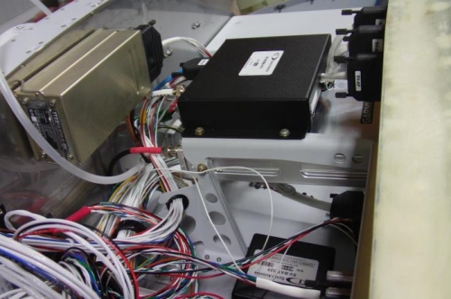

Removed radio and installed ADS-B brackets to com radio tray as part of the tray installation on page 42G-03. Installed ADS-B receiver and secured to brackets. Routed ADS-B harness and connected to receiver and AV-5000A control module. Connected antenna cable to receiver. (steps 1 through 5)
PAGE 53-06 IS COMPLETE
Page 53-10
Installed 2 Amp fuse in GPS ADSB slot in the power & switch module. (step 1 partial)
Receiver In (LH Side)
Receiver In (RH Side)
