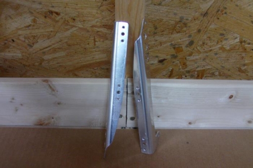

Brief Description:  Prep ADS-B Mount Brackets
Separated ADS-B brackets and removed identified areas. Machine countersunk rivet holes for nutplates. Deburred, scuffed parts with Scotch Brite pad, cleaned with Acetone, and primed with Stewart Systems Ekoprime. Riveted nutplates to ADS-B brackets. (steps 1 and 2)
PAGE 53-05 IS COMPLETE
Deburred & Scuffed
Deburred & Scuffed
Cleaned, Primed, & Nutplates Installed
