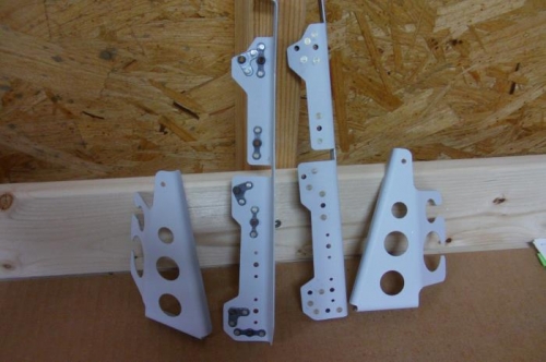

Brief Description:  Prep & Install Stack Angles & Com Support Brackets
Separated stack angles. Deburred stack angles and com support brackets. Machine countersunk rivet holes in stack angles for nutplates. Scuffed parts with Scotch Brite pad, cleaned with Acetone, and primed with Stewart Systems Ekoprime. Installed nutplates on stack angles. (steps 1 through 3).

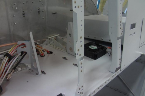

Removed old stack angles and com support brackets previously installed on panel base. Riveted new stack angles and com support brackets to panel base. (step 5)
Prepped & Scuffed
Prepped & Scuffed
Cleaned, Primed, & Nutplates Installed
Installed on Panel Base
