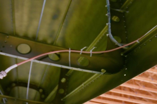

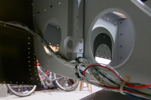

Brief Description:  Finalized ADS-B Coax Run

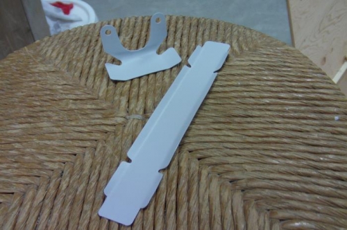

Bent F-00049 wire cover plate. Deburred, scuffed with Scotch Brite Pad, cleaned with Acetone, and primed with Stewart Systems Ekoprime. (page 53-07, step 1)
Positioned F-1016HX guide bracket on side of F-1207D-L baggage bulkhead channel and match drilled. Deburred, scuffed with Scotch Brite Pad, cleaned with Acetone, and primed with Stewart Systems Ekoprime. Riveted guide bracket to channel and routed ADS-B coax through hole. Split snap bushing and installed inside guide bracket. (page 53-08, steps 1 through 6)

Drilled three holes in F-1208 fuselage frame and deburred. (page 53-09, step 3). Routed ADS-B coax along existing tail cone wires and secured with tie wraps. Loosely installed tie wraps in the three drilled holes and will tighted after installing antenna.
Bent F-00050 wire routing bracket. Adjusted radius bend and aligned with holes in flap handle blocks. Deburred, scuffed with Scotch Brite Pad, cleaned with Acetone, and primed with Stewart Systems Ekoprime. (page 53-11, step 1)
Coax Guide Bracket
Coax Guide Bracket
Aft End of ADS-B Coax
Cover Plate & Routing Bracket
