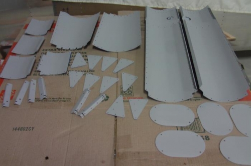

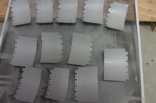

Brief Description:  Primed New Skins
Scuffed inside surface of bottom skin with Scotch Brite pads.
Cleaned all prepped and scuffed parts from last night with Acetone and primed with Stewart Systems Ekopoxy primer.
Dimpled K1000-8 nutplates and riveted to access hole openings and communication antenna location on bottom skin. Installed four plugs for access to main landing gear bolts. Installed system block studs and lower system blocks.
Finally! Skins are ready for installation - probably on Wednesday.
