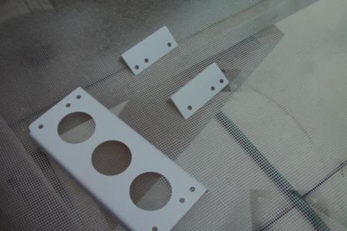

Completed Bearing Bracket Mod (SB 14-12-06)
Cut bearing bracket angles (step 6).
Scuffed angles and bracket with Scotch Brite pad and clean with Acetone, then primed.

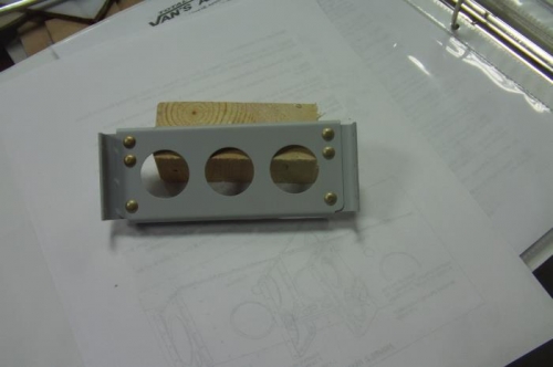

Riveted bearing bracket angles to bearing bracket (step 7).

Angles Made & Parts Primed
Angles Riveted to Bracket
