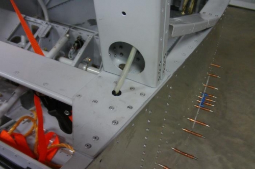

Step 6 - Routed wire through snap bushing in roll bar attach plate. Also routed eyeball cockpit light wires as well.

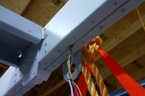

Step 7 - Routed wires through wire tube, then installed wires and wire tube up through roll bar until three wires (one for canopy latch switch and 2 wires for eyeball light) exited the hole at the upper end of roll bar. Installed modified snap bushing (flanges sanded to fit between roll bar halves) over wire ends and secured into roll bar.
Wires and Wire Tube
Wires and Wire Tube
Wires Exiting Roll Bar Bushing
