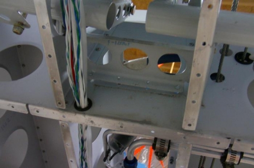

Remove Old Bearing Bracket Brace (SB 14-12-06)
Since the bottom skin and flaperon pushrods are already removed to address damage from mice, started to comply with SB 14-12-06 while access is good.
Step 1 - Order parts form Van's - Done.
Step 2 - Remove wings - NA (wings already removed).
Step 3 - Remove fuel tank - NA (fuel tank not installed yet).
Step 4 - Remove baggae covers and disconnect flaperon pushrods - NA (already removed to address mice damage).

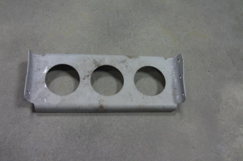

Step 5 - Removed F-1206F Bearing Bracket Brace.
Rivets Removed from Brace
Brace Removed from Aircraft
