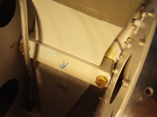

Step 46
Manuevered each gear leg and outboard main gear attach brackets into position and loosely installed AN5-22A bolts, washers and nuts.
Step 47

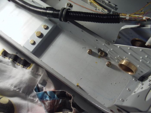

Installed U-1203B inboard wear plate, U-1203E inboard doubler plate, U-1203 inboard main gear attach bracket, and U-1203C doubler plate. Tightened and torqued AN6-25A bolts and then AN-24A bolts. Tightened outboard bolts but did not torque yet. Need to find aa way to get on nuts to final torque.

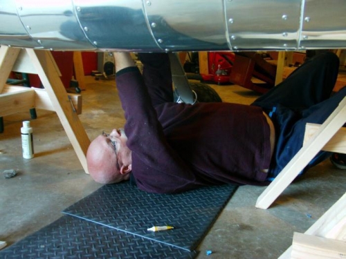

Assuming the Position!
Bolted Up - Top of Center Section
Outboard Main Gear Attach Bracket
