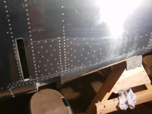

Riveted F-1270A side skin doubler to LH side of fuselage.structure. Had the same problem with one CHERRYMAX rivet where stem broke off before being fully set and collar didn't set when looking at the manufactured head. Drilled out and replaced the rivet three times and still have the same problem. Not sure what's going on but the rivet needs to be replaced with a properly set rivet.
LH Side Skin Doubler Riveted

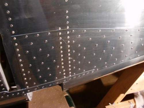

Closer View
Closer View

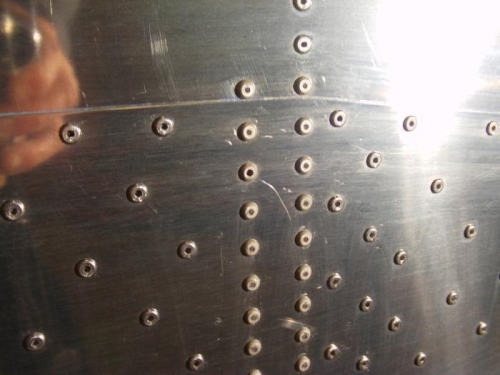

Rivet Not Fully Set (3rd from top)
