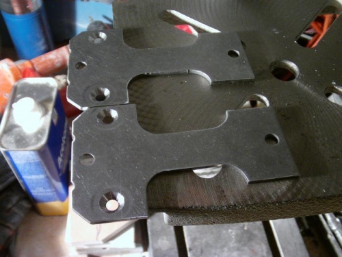

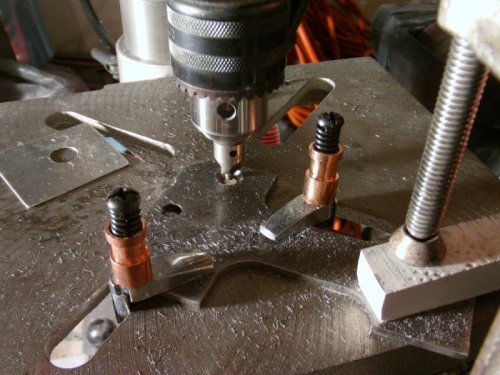

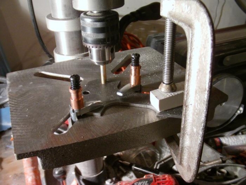

Machine countersunk holes on bottom sides of U-1202D-B outboard wear plates. Used scrap AN4 bolt to align holes in drill press. Cut with 100 degree countersink using machine oil. Verified that AN509-416R17 screw head sits flush with wear plates.
Drill Bit Centering Hole
Countersinking Hole
Countersinking Hole
Countersink Results
Countersink Results
