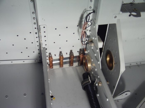

Skin Attach Flanges (SB 12-11-09)
Step 22
Machine contersunk holes in F-1270D side skin doublers for CS4-4 rivets. Directions say to also countersink F-1270A that take CS4-4 rivets but there are no rivet locations specified for this doubler in Figure 6.
Step 23
Separated F-1204B-L & -R and F-1204T-L & -R skin attach flanges.
Step 24
Applied a slight upward angle on F-1204B-L & -R skin attach flanges.
Step 25
Clecoed F-1204B-L & -R skin attach flanges into position and match drilled holes in flanges.
Step 26
Removed F-1204B-L & -R skin attach flanges and deburred holes and edges. Also deburred holes and edges of F-1204T-L & -R skin attach flanges.
F-1270D Skin Doublers Machine Countersunk
F-1204U-B Skin Flanges Match Drilled
