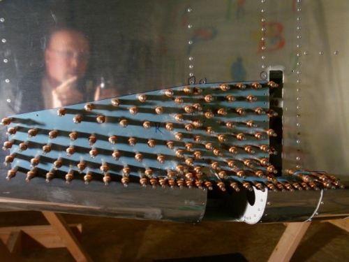

Removed blue vinyl plastic from mating surfaces and clecoed F-1270A and F-1270D side skin doublers to sides of fuselage.
Step 21
Match drilled holes in F-1270A and F-1270D side skin doublers into sides of fuselage and adjoining structure.

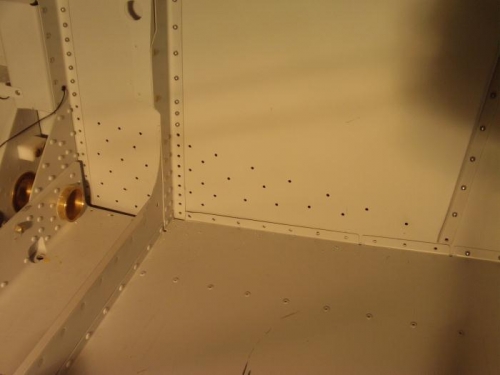

RH Side Skin Doubler Match Drilled
RH Side Skin Doubler Removed
Drilled Holes (RH Baggage)
