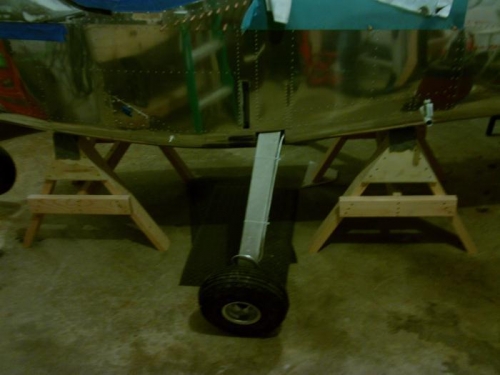

With Michael's help, used new maintenance stands and raised aircraft off of the ground. Positioned stands at locations specified on page 1-18 of the Maintenance Manual.

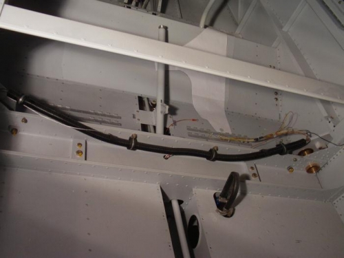

Removed two outboard cushion clamps securing F-1204Y wire run conduit.

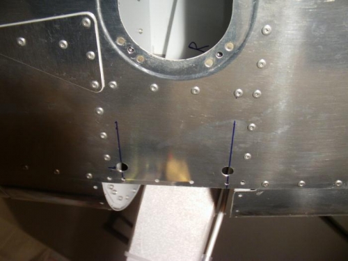

Marked and drilled 3/8" holes in F-1276 bottom skin on both sides of the fuselage.
Aircraft on Maintenance Stands
Wire Run Conduit Loosened - Outbd Ends
Holes in Bottom Skin
