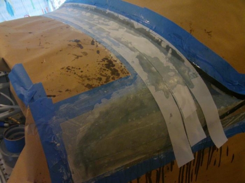

Brief Description:  Applied Center Fiberglass Portion
Removed peel ply and lightly scuffed previous lay-up. Brushed away sanding dust. Applied all 10 layers of fiberglass on center of canopy. I don't know if the smaller pieces were easier to work with or my fiberglass installation skills got better overnight, but today's session was much easier. Covered fiberglass lay-up with peel ply. (page 34-15, steps 2 through 4).
