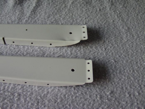

Brief Description:  Bought Fiberglass & Replaced RH Support Frame

Also, received new F-1254-R support frame from Van's. Decided to replace after noticing interference between turtle deck skin and canopy skirt (reference entry on 6/24/12, Category 34) that was damaged while shaping the canopy frame. Trimmed edges, deburred, scuffed with Scotch Brite pad, cleaned with Acetone, and primed. Applied coat of clear gloss Krylon. Realized that I forgot to dimple holes in support frame before priming so will need to do that after part is dry.
New vs. Old Support Frame
